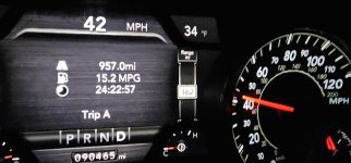

i know Banks is a sensitive subject on this forum, but after i installed the monster intake and CAI setup, i only go into full regen every 24 hours now and the gauge never goes above 10% between that. When it does the 24 hour regen, it lasts for about 12 miles at this point. Last regen was at this numberregen.jpg
dont mind the mpgs, had just got done towing my 12k toyhauler

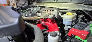

people poopoo on it, and say snake oil, might be the case but it looks good and makes great truck sounds now lol. CAI really makes the turbo whistle loud. the intake i cant say did anything but looks good and opened the system up when it replaced the heater grid. 0 regrets.
